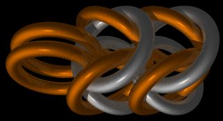

Step 1: Pass two open rings through four closed rings and lay them out as shown.

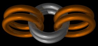

Step 2: Fold the two rings on the end of the chain back.

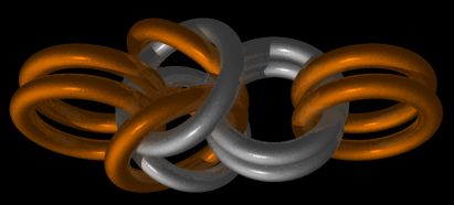

Step 3: Place two closed rings on an open ring. Pass the open ring through the two rings on the end of the chain that you folded back in the previous step. Add another open ring where the last one went.
Step 4: Fold the two rings on the end back again.

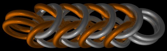

Finished box chain:
