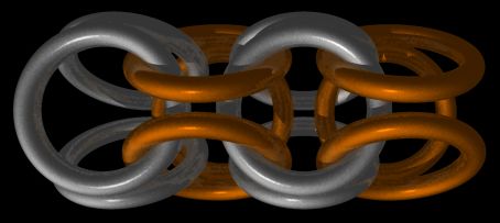

Step 1: Create a 2-1-2-1-2 chain as shown.

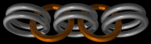

Step 2: Connect the ends of the chain with a new ring.
Step 3: Pull the chain apart so that it looks like this:

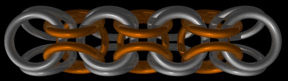

Step 4: Add three new rings onto the end of the piece. Repeat this step to lengthen the chain.
That just about does it. As with roundmaille, you can speedweave this chain if you like by just adding open rings in with the closed ones in step 4.

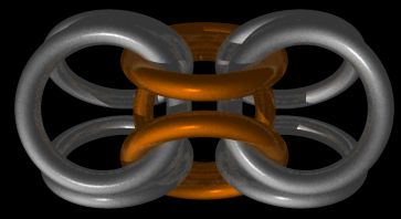

Finished Inverted Roundmaille weave:
