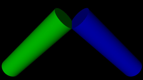

cylinder
-2*y, 2*y, .5
rotate -45*z
translate -1.7*x
pigment {color rgb z}
cylinder
-2*y, 2*y, .5
rotate 45*z
translate 1.7*x
pigment {color rgb y}
Two cylinders
We want to smoothly join these two cylinders. Doesn't look too easy, does it? The blob object is a way to smoothly join together spheres and cylinders (unfortunately, it does not work with any other objects). Here's an example of how the blob works:
