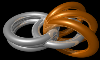

Step one: Pass three closed rings through three open rings and lay them out as shown.

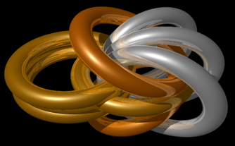

Step two: Add two more rings through the rings you added in the previous step.

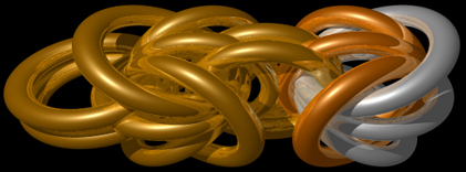

Step three: Pass two rings through the two rings you added in the previous step and the middle ring from the first step.

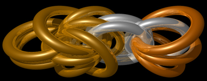

Step four: Place a closed ring between the two rings added in the previous step. Lock that link in by passing three rings through it and those two old rings.

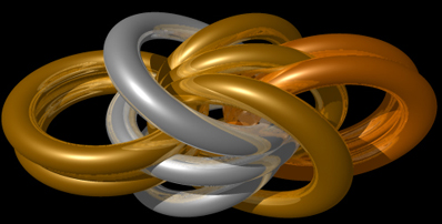

Step five: Add two rings next to that closed ring added in the previous step.
That's it! Repeat steps three through five to lengthen the chain. Some fantastic weaves can be made by alternating the metals used. Good luck!
Finished Trizantine chain:
